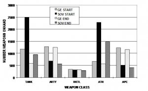

    (1) Force Level Comparison. As shown in Figure1-1, at the start of the campaign, the Germans were outnumbered at least 2:1in tanks and at least 3:1 in heavy antitank (AT) weapons and light infantry support weapons (machineguns (MG), mortars, and light AT weapons). Initial German parity or superiority ininitial inventory existed only for artillery, rockets, armored personnel carriers (APCs), and antiaircraft weapon classes. From 5-18 July, an average 98 percent of onhand German tanks and 97 percent of German heavy AT weapons were in contact with the enemy, as opposed to an average of only 64 percent of Soviet tanks and only 67 percent of Soviet heavy AT weapons.
    Figure 1-1. Onhand Major Weapons at Start and End

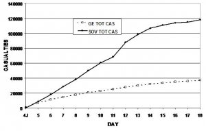

    Figure4-5. Cumulative Total Casualties

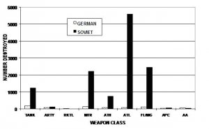

    Figure5-10. Total Destroyed Weapons by WeaponClass

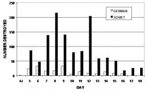

    (2) Daily Tanks Destroyed. Figure5-11 shows daily number of tanks destroyed for each side during the period 4-18 July. Soviet tank losses peaked on 8 July and 12 July, while maximum German losses occurred on 6 July and 9 July. The Soviet peak on 8 Julycorresponded to a major German “push” by 48 Pz Corps, during which 3 PzDivision and Grossdeutschland PzGrD were heavily opposed. Almost all Soviet tank losses on 8 July werein four units (3 Mech Corps, 31st Tank Corps (TC), 5th GDs TC, and 6thTC). The high Soviet tank losses on 12 July reflect the initiation of Soviet counterattacks on that day and the battle of Prokhorovka. On 12 July, 18th TC,29th TC, 2d GDs TC, and 5th GDs TC suffered most of the Soviet tank losses.
    Figure5-11. Daily Destroyed Tanks

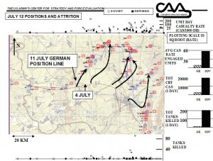

    c) Day by day log : 12 Luglio : Prokhorovka
    (1) Combat Postures/Dispositions. Many Soviet line units (25 of 48) are counter-attacking today, most of them concentrated to stop the 48 Pz Corps and 2 SS Pz Corps in the center. All other on line Soviet units are in defense postures, most (15) in hasty defense. Most of the counterattacking Soviet units (21 of 25) are forced into hasty defense postures by 14 July. German 198 ID came on line on 10 July. The German 167 ID, 255 ID, 320 ID, and 57 ID are in prepared defenses. Das Reich and Grossdeutschland(GDPZ) are forced in hasty defense. All other German line units are attacking.
    (2) Progress. German 48 Pz Corps and2 SS Pz Corps have made progress since 8 July, but their advance has stalled,with 11PzD and Totenkopf SS in the lead. Recent progress has been made on the German right by 6 Pz D, which has moved 11.4 km farther north in 1 day but is surrounded by Soviet units. Although average northward progress for the day for the entire German force is 2 km, four German units (57 ID, 3 PzD, 198ID, GDPZ) moved an average 2 km south today. The largest northward advances since July 8 were made by Totenkopf SS (30 km) and 6 PzD (22 km). Average German northward progress since 4 July is 16.5 km. Largest northward progress since 4 July was made by Totenkopf SS (40 km) and 11 PzD (32 km), which is the most forward unit of the force. The German line will advance no farther north after today, with 11 PzD and Totenkopf SS holding the northern most positions through 18 July.
    (3) TankLosses. Total Soviet tank losses (204) are over 20 times German (9). The vast majority of today’s tank conflicts are near Prokhorovka, where the counterattacking Soviet 29 TankCorps, 18 Tank Corps, and 2 Gds Tank Corps lose a total of 144 tanks against Leibstandarte SS, Totenkopf SS, and Das Reich, which lose a total of 6 tanks (4Pz III and 5 Pz IV). Highest Soviet tank losses (88) are in 29 Tank Corps, which loses 60 T-34s and 28 T-70s. Highest German tank losses (four) are in Leibstandarte SS. Most of the Soviet losses are T-34s (119), T-70 (61), and MK-4 Churchill (13). Recorded as damaged in action today are 89 German tanks and 210 Soviet tanks.
    (4) Personnel Losses. Total Soviet combat casualties (19,400) are almost 8 times the German total (2,450). Soviet casualties are very high on their left flank, with 270 RD and 73 Gds RDlosing over 15 percent of personnel. The Soviet unit with the worst losses (28 percent) is 184 RD. Highest German casualty rates are in thec enter, with 167 ID losing 3 percent of personnel and Leibstandarte SS losing 2 percent.

    Mi ha però fatto riflettere molto la prima : se il kill-ratio era nettamente favorevole ai tedeschi, ma il ratio delle "temporary losses" è molto più equilibrato, ci possono essere tre cause ( o probabilmente un mix) :
    a) tattiche migliori, che riducono il numero dei caduti da parte tedesca (e i tedeschi furono generalmente all'attacco contro linee difensive preparate e disposte in profondità) o viceversa per i sovietici ;
    b) maggiore efficienza del servizio sanitario (molti feriti russi morivano ...) ;
    c) maggiore letalità del munizionamento tedesco, che provocava un più alto rapporto KIA / Total losses (o viceversa per i sovietici).
    Anche il caso delle perdite di AFV è emblematico : un rapporto di 5,6 AFV danneggiati per AFV distrutto per i tedeschi, contro un rapporo < 1: 1 per i russi ! O il munizionamento / cannoni tedeschi funzionavano molto meglio, o la mira dei sovietici era molto più scarsa ... :)
    In ogni caso quel rapporto con 200+ pagine di tavole è una miniera.
    Chissà perchè non è stato utilizzato da altri (mai visto nelle bibliografie di altri autori ...)
    P.es. nella immensa bibliografia di "Kursk" (Glantz), che pure è successivo, non c'è traccia. E Glantz è US Army ... boh ...
